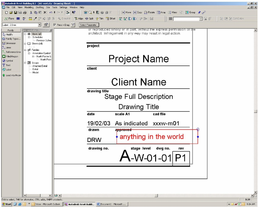

Your title block should look something like this:
(click to enlarge)
Save your title block and load it into your project.

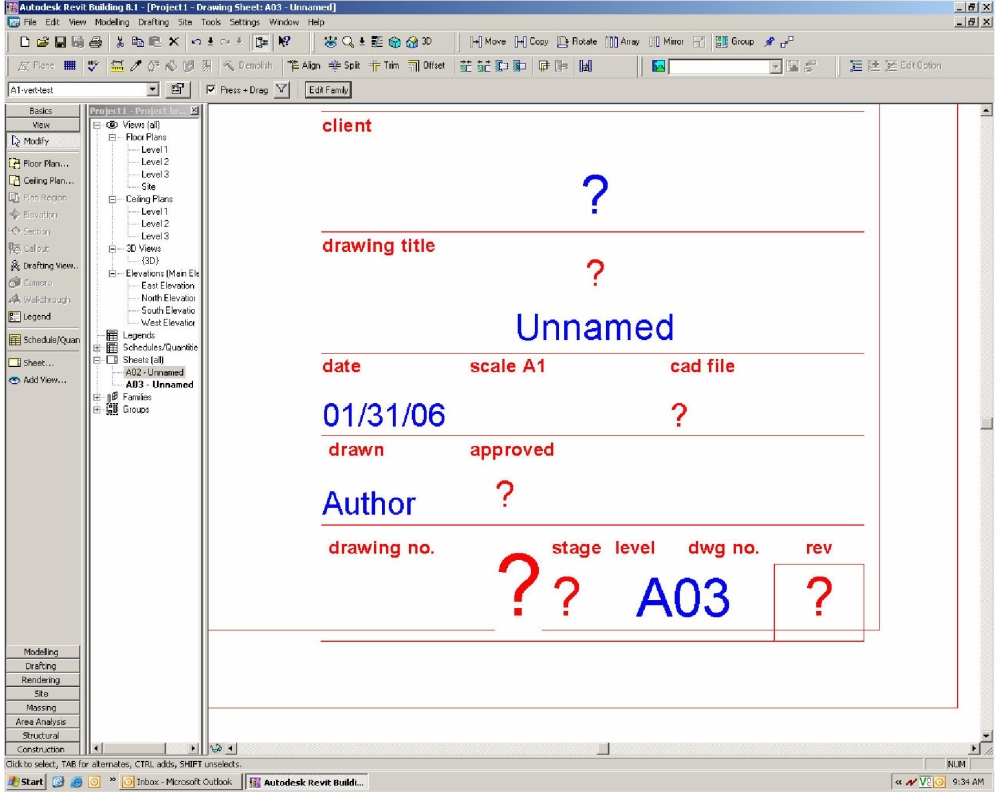

When you click on the title block in your project you will notice that the label we created earlier is red and not editable, this is because we need to load the shared parameter into the project.
(click to enlarge)
from the File menu go to "shared parameters" and make sure your "anything" text file is selected and your "anything in the world" is shown.
Next, from the "setting" menu go to "project parameters"...
Click "add"...
In the next dialogue box make sure "shared parameters" is ticked.
(click to enlarge)
Click "Select"... and your "anything" text should be there, click OK,
Now we need to associate this parameter with our title block, so on the right pan click on "Drawing Sheets"
Click OK again and your done!
Now when you click on your title block the "anything in the world" parameter is blue and can be edited...
