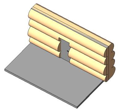

Click Finish Sketch and the wall is ready.
Too make an opening or several choose Void and then Set Work Plane – Pick a Plane – and click a plane at right angles to the wall.
Use lines to draw a rectangle and then an Extrusion Path of suitable length. Click Finish wall.
To place a window or door in the wall you have first to make a hidden normal wall inside the sculptured log wall and then place the window or door in that wall.
