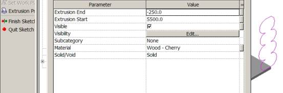

Choose Set Work Plane and then Pick a Plane – click one of the sides of the floor:
Now you can begin with Lines to draw the contour of the wall. Perhaps easiest is to begin with drawing a rectangle and then for a timber wall use Arc through three points.
This is the result. The contour can not have any openings and no crossings.
Choose Extrusion Path and fill in some suitable values. You can use negative values, too! Choose a material: Wood – Cherry perhaps a little too exclusive, but this is just an experiment.
