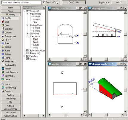

16.   Then Finish Sketch and I could use the arrows on the Void to make it cut out the part of the roof I wanted.
(click to enlarge)

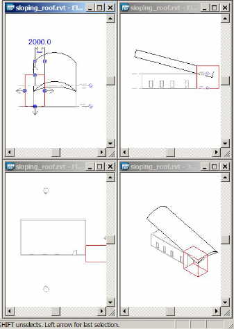

17.   And I could select a wall and then click the Button Attach and click the roof.
(click to enlarge)

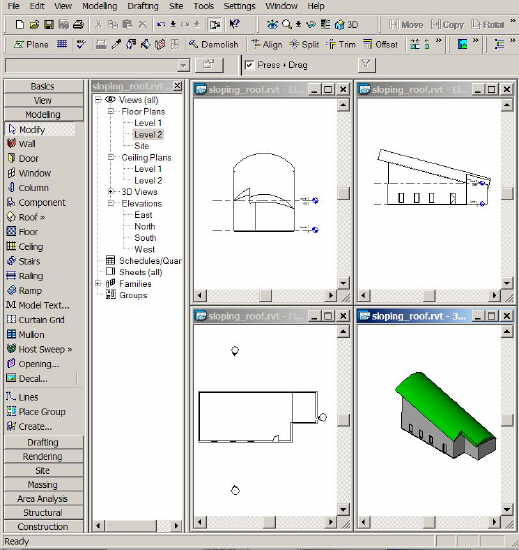

18.   And perhaps continue with making some new walls under the roof and attaching them.
(click to enlarge)
