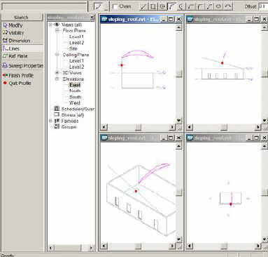

10.   Click Line on the Design Bar. I used Arc passing through three points to make two interconnected curves. Click Finish Profile.
(click to enlarge)

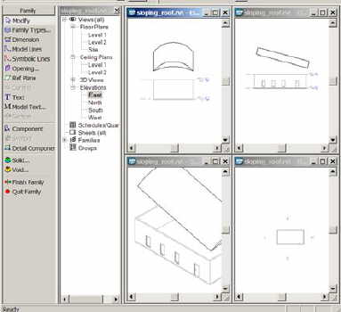

11.   Then I clicked Finish Sweep and got this.
(click to enlarge)
12.   I could now move the roof a bit down. I discovered that I needed a roof that was a bit longer so I clicked the button Edit with the roof selected.
(click to enlarge)
