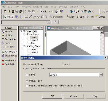

3.   Name it to something fancy or just accept the default name.
(click to enlarge)
4.   Choose Solid on the Design Bar and then Sweep.
(click to enlarge)
5.   Click Sketch 2D Path on the Design Bar.
6.   Click the Plane button or click Set Work Plane on the Design Bar or on the menu Tools > Work Plane > Set Work Plane and choose to Pick a Plane.
(click to enlarge)
