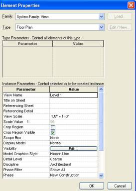

You can now set the Pen Number for the Projection, Cut or the Line color etc for the Subcategory you have just created. Along the bottom of the Pop Up, Select Apply and then OK. Close the Object Styles box now, and go to the View properties of the Project you are working on.
(click to enlarge)

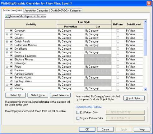

Select the Visibility Box, and the Visibility/Graphic Overrides Box pops up (image below).
(click to enlarge)

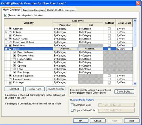

Select the “+” beside the Doors Category to expand the Category. You should now see the new subcategory you created (image below).
(click to enlarge)
