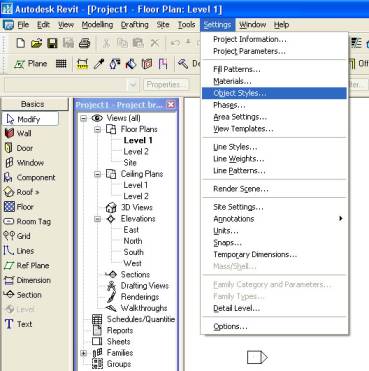

On to Object Styles and Pen weights…. Go to Settings, and to Object Styles (image below)

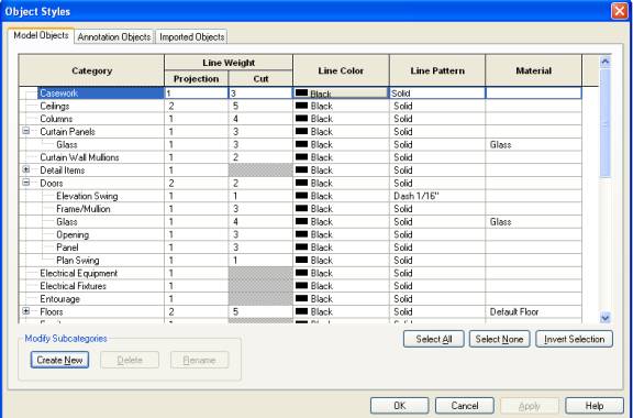

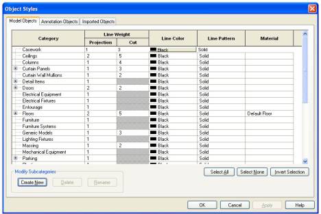

Note on this pop up you have three tabs across the top Model, Annotation and Imported Objects. Here you can set the number of the pen from the Line weight Chart to use (2nd image on first last page). So if you want Casework to be pen one in elevation, you would put a “1” under the Line weight – Projection box beside the listed Category of Casework. (As is shown above). The cut category applies to sections and plan views, WHEN an object is CUT – otherwise it is “ELEVATED”. So here when cut in section or plan, a casework object will be drawn with pen 3. Note on this pop up you can also set the line type – dashed, hidden, center etc and the color that this object is displayed on the screen (another way of mentally telling yourself what pen your drawing with – This is an Autocad user compromise (crutch) – Try not to use it, but you might have to set something up like that in a larger firm)….
Looking at the image above again, go to “Doors” – Note the “+” sign beside the text. This indicates that there are additional “ layers – actually types of objects” under this category.
When selected, this “+” changes to a “-“ (allowing to expand or contract this category). And additional layers or subcategory types are listed under this Category. This allows you to select pen weights for different aspects of a base object, along with the ability to turn these aspects either on or off in a view. Selecting “Doors”, the Category expands to expose the additional “Subcategories.” Look at the image below.
