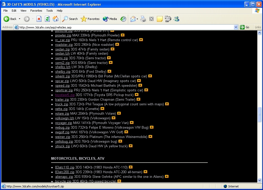

From the links page here at RevitCity is a link to the "3d cafe" website. This is a great source of material and where I started this tutorial.
1.   Identify and download the object you desire. This is usually a zip file and for the purpose of this exercise, I will assume it is in a .3ds file format. (also that you know how to unzip and locate the file).

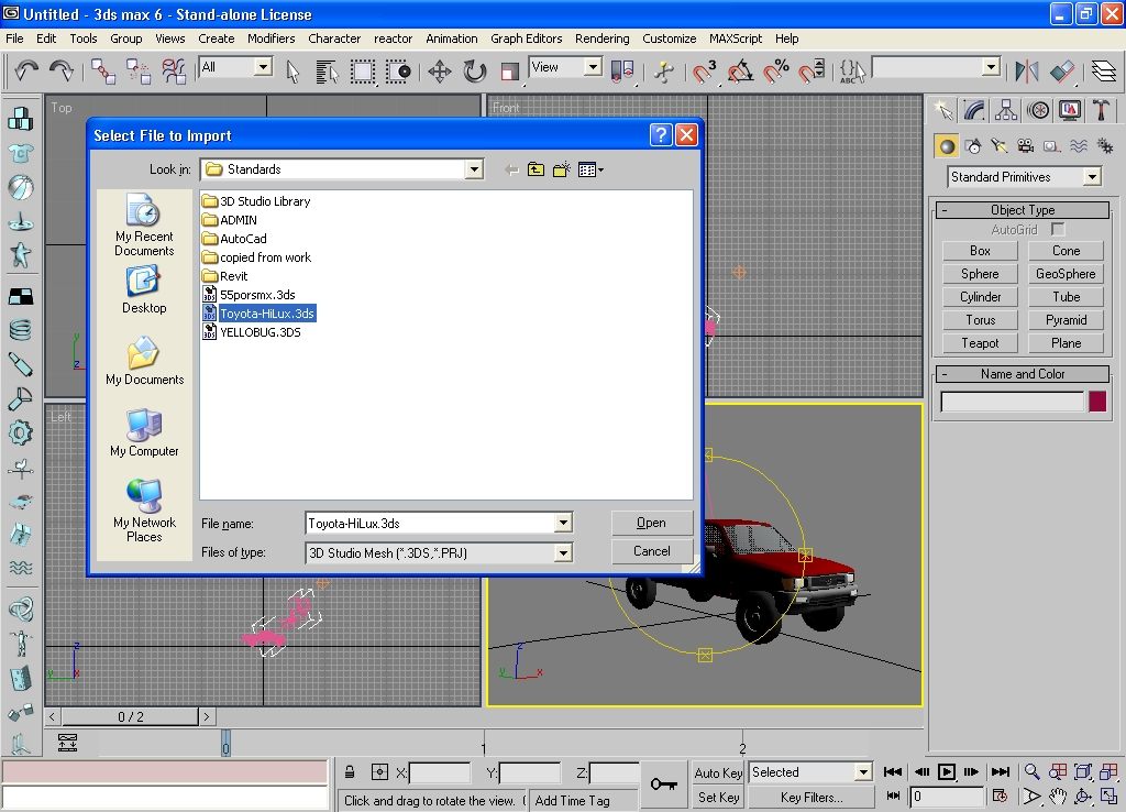

2.   Open your copy of 3D studio Max or Viz, and go to "file", "import", then select the file you have just unzipped. Select "completely replace screen".
