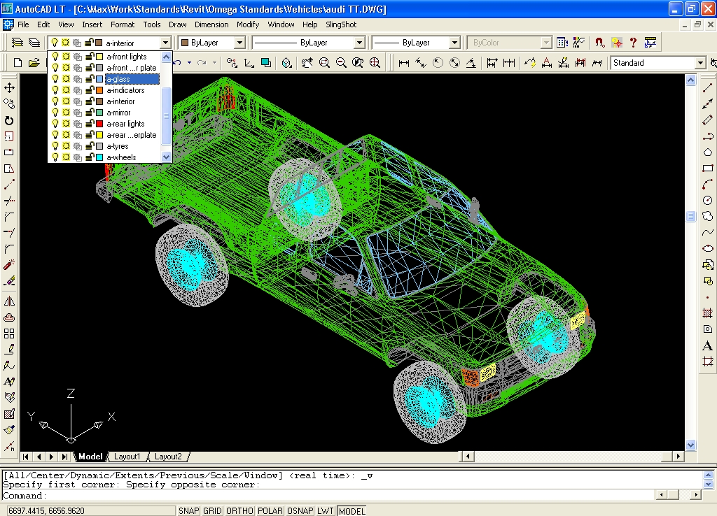

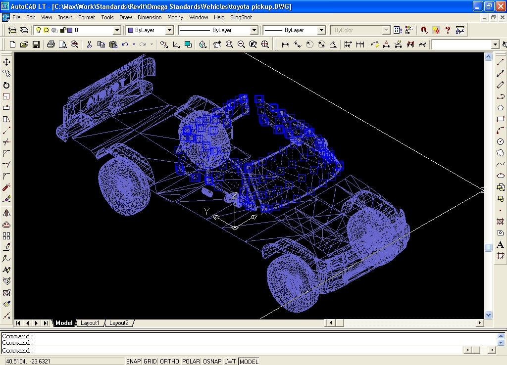

6.   Create new layers: You will find that there is usually only one layer within the dwg. For later use, its best to create a series of new layers (I name them to correspond with the material I will later apply in Revit), for instance, "Toyota paintwork", "Toyota glass", "Toyota wheels" etc. For ease of viewing, ensure these have all different colours (the actual colour is irrelevant unless you are very fussy!).
7.   Once the layers are created (normally no more than seven or eight are needed), you need to pick the individual meshes, one at a time and assign them to those layers. I find it easiest to start with all layers switched off except for the layer the object started in. Then, for example, select the main bodywork , and assign the new layer to it. You will see it then disappears (as the new layer it has gone on to was switched off) thus just leaving the objects that you still need to assign a layer to.
(click to enlarge)
8.   Once all the objects have disappeared (it takes a few minutes), switch everything back on and take a look. Type "shade" to view it as a shaded object if you prefer. Try to see that your material distribution matches that of the real object. (For many of the cars I have imported, I will check out the manufacturer websites to see images of what material goes where on the real vehicle for an authentic visualisation). Save the file, close AutoCAD.
