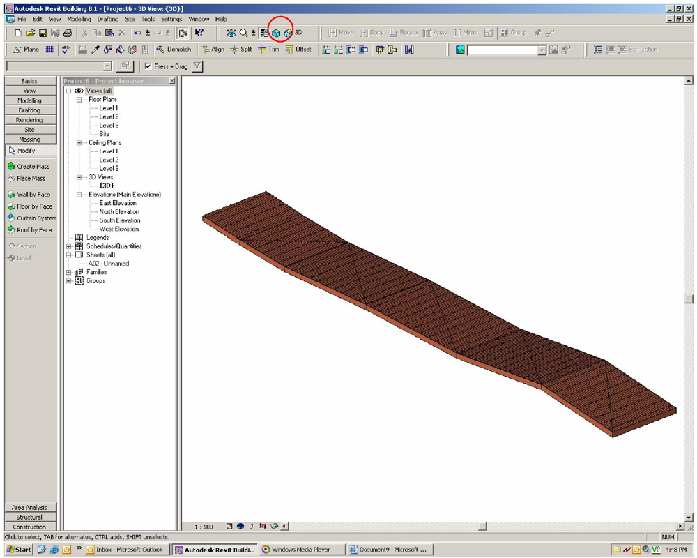

10.   Revit will create your roof, in order for you to see it, you will need to hide mass. Now our path looks like this:
(click to enlarge)

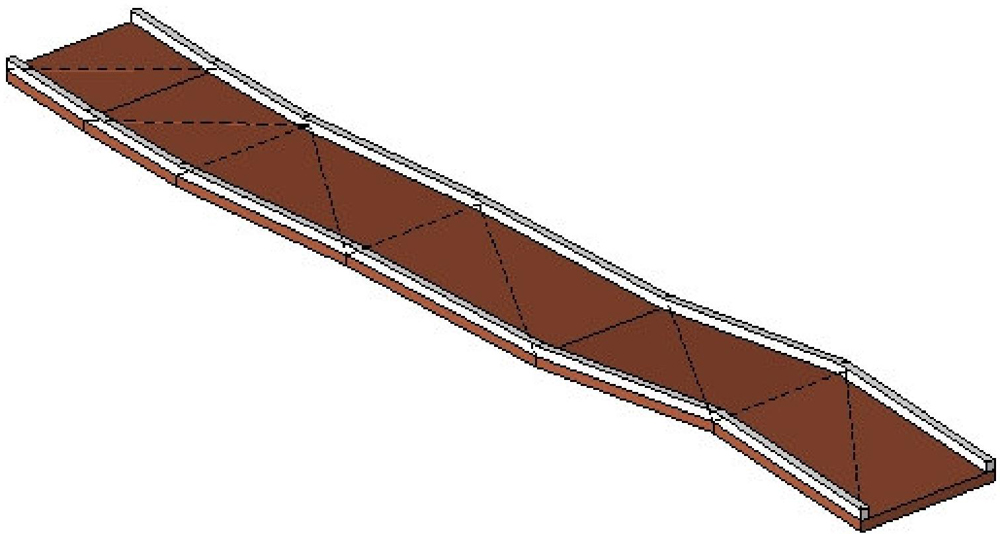

As you can see, Revit uses triangulation to interpolate the point and that leaves some lines on the path, you can use the “Linework” tool to get rid of these lines and clean up your path.
11.   Next, we are going to add a curb to our path, Under the “Modelling” tab click Host Sweep->Roof Fascia, choose your profile and click on the edges of the path to create your curb, to look like this:
(click to enlarge)

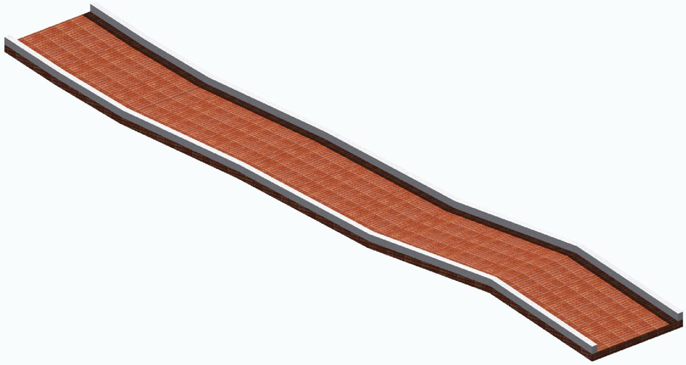

This tutorial can apply to many situations and it’s only a base for you to explore further. This is how my path looks like now:
(click to enlarge)
