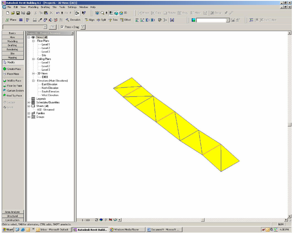

8.   In your project, click the “Massing” tab and choose “Place Mass” go to 3D view for a better view.
(click to enlarge)

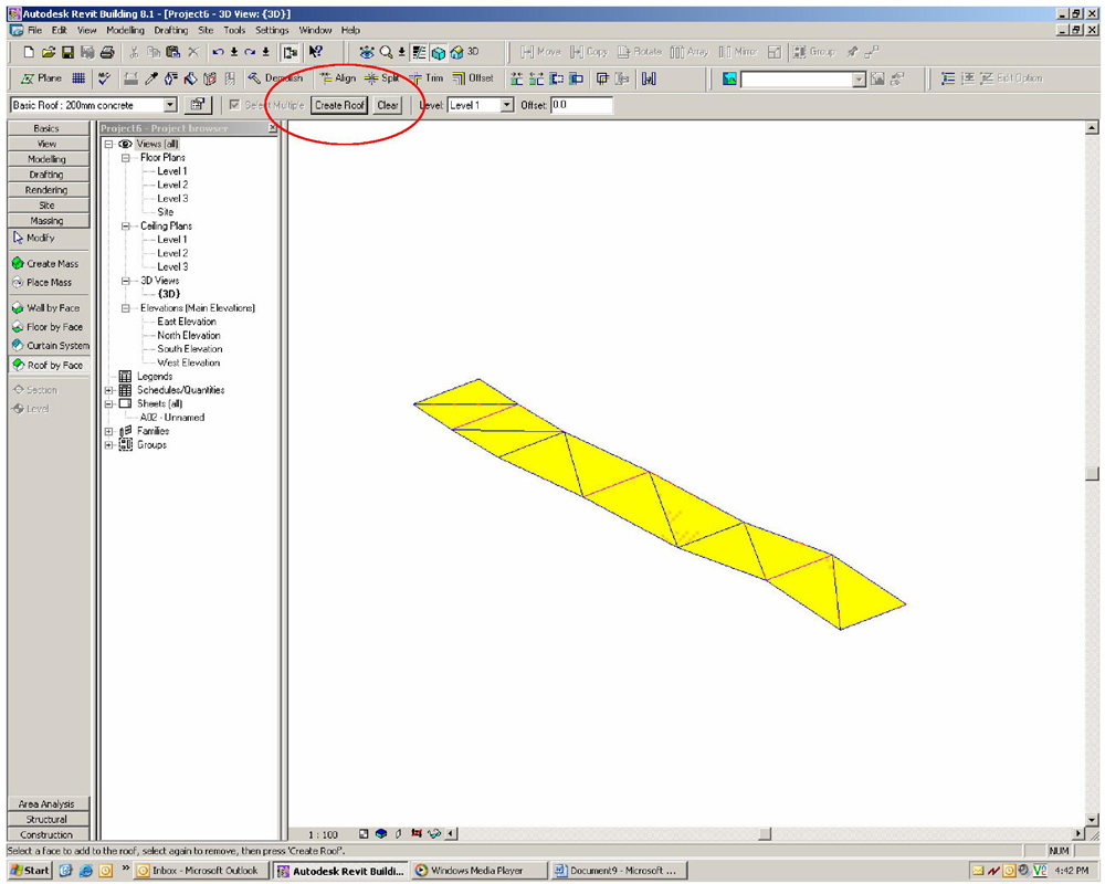

9.   Click “Roof By Face” edit the roof and change properties to suit you, I changed it to a 200mm concrete roof with a paving render. Pick the whole mass and click “create roof"
