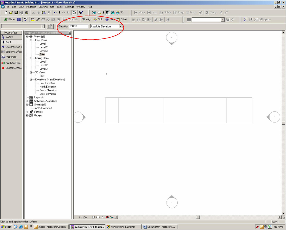

1.   open a new project and click on the “site” tab
2.   click the “toposurface” and proceed to create your shape using points.
(click to enlarge)

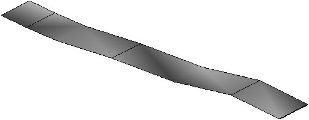

3.   Finish surface and go to 3D view, my path looks like this:
(click to enlarge)
