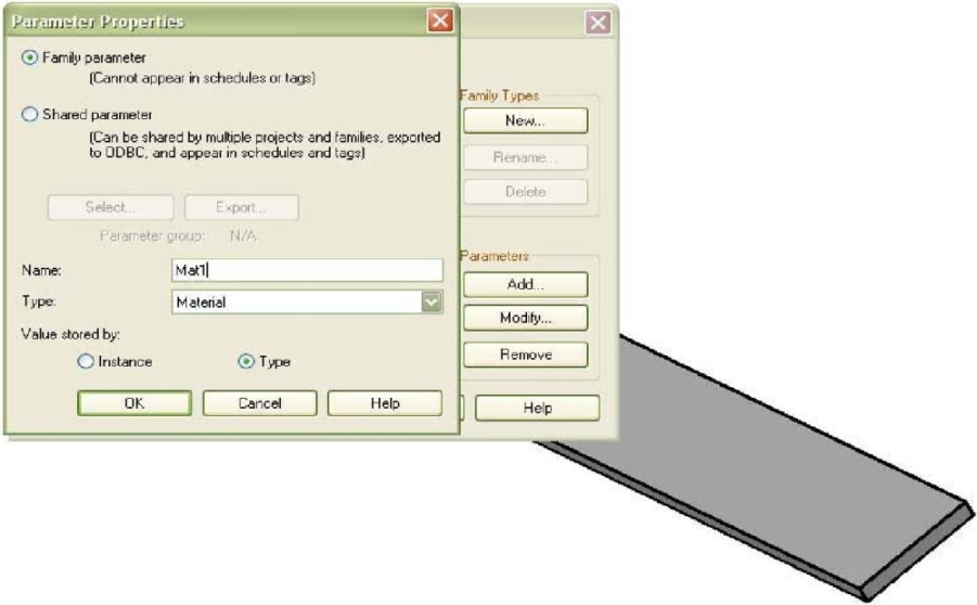

11.   We now need to create a material parameter for our louvre so we're not stuck with default grey. Click Add... in the parameters menu as seen above and give your material a name (I called it Mat1) then choose the type of parameter you wish to add
from the drop down menu. Select Material and Type. Now click OK.

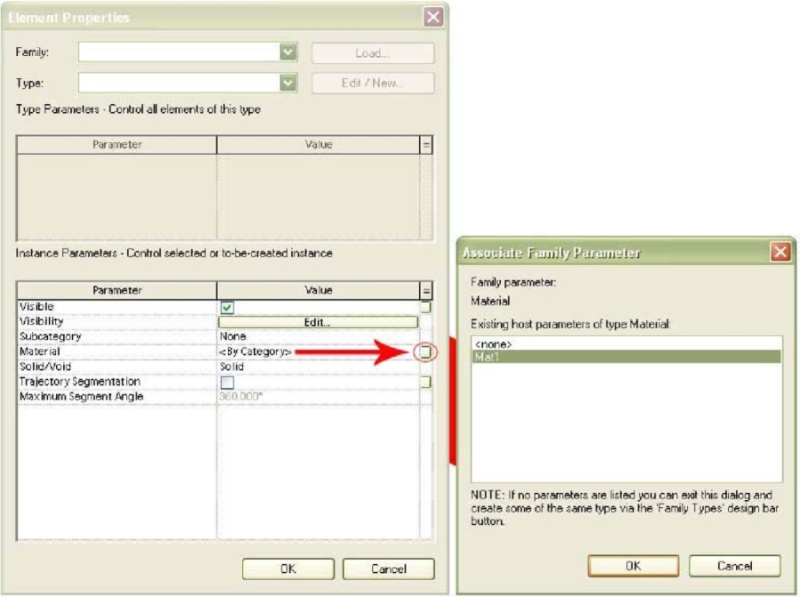

12.   At the moment this material isn't linked to our louvre so changing it at the moment will have no effect on our louvre. To link it, go to the 3D view and select the louvre. Go to the properties of the louvre. Where the louvre material is defined, in the far right hand column there is box select this as shown below then choose the parameter you want to link. In my case Mat1.
