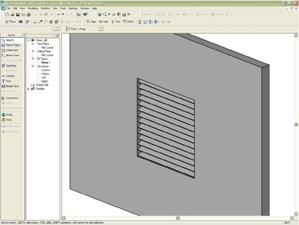

28.   The final step is to test out these parameters to see if everything adjust as desired. Now save your new louvered window in an appropriate place for use in your next project.
(click to enlarge)
