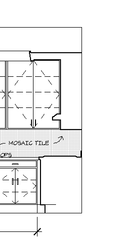

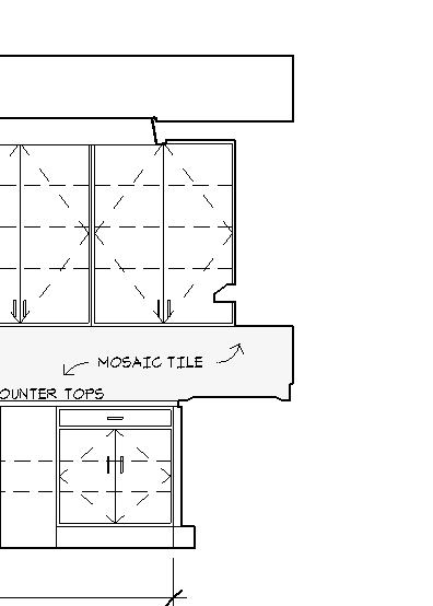

So I am working on some interior elevations and I am using Filled Region (Solid White) cover up some linework and make the elevtion look correct.  In view it looks fine.  But when I print or look at print preview they show up when they're not supposed to.  Does anybody know why?  I want my filled region to cover everything up when printed too.  Thanks
