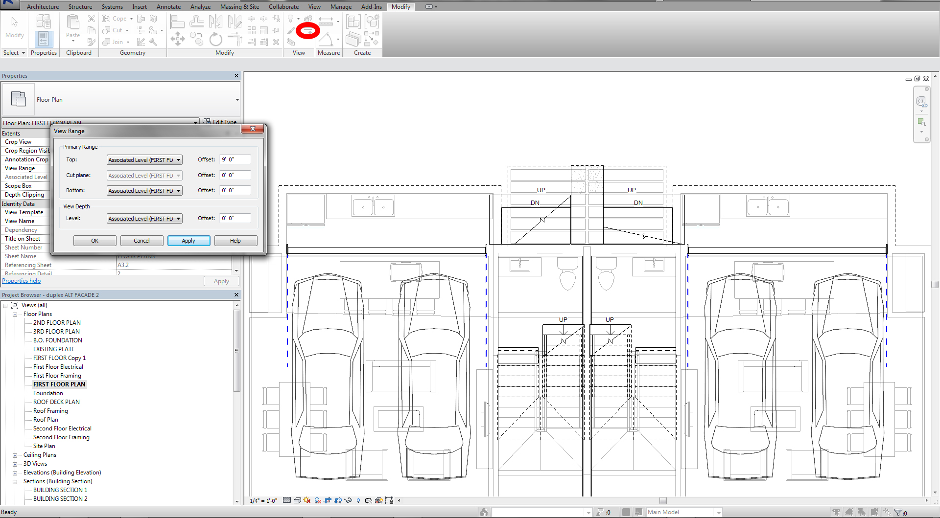

so i have canopy at 2nd floor level (image 1) that i need to show dashed in 1st level (IMAGE 2). while in 1st level view i select 2nd level asunderlay. thi thin is, canopy is not showing as underlay, so i can not use line work tool. as you can see on image 2, 2nd level overhangs on the side of canopy are showing as underlay and i was able to use line work tool to show them dashed. so how do i get the canopy to show? while playing with ranges, if i set 1st floor cut plane to 0, canopy will show. however if i use line work tool now to make dashed outline and then set my 1st level cut plane back to 4' i can no longer see dashed outline. any ideas?

Tue, Jan 31, 2017 at 4:22:47 PM | trying to show canopy above
DavidBruinsma
Joined: Sun, Jun 3, 2012
13 Posts
5 Stars: 1 Votes
a couple of quick things to check
- is the underlay Orientation set to "Plan" or Reflected Ceiling Plan"
- try changing the Graphic Display to "Wireframe"
If either of those options (or both together) help, then use the linework (LW) tool to select the object and pick with a dashed type line overide.
Good luck.

i tried to set underlay to both ceiling and plan, canopy doesnt show in either one. it does not show in wireframe mode either.

i just cant get this figured out. there is nothing above or below canopy that would be obsuring it. what puzzles me is that it becomes visible when 1st floor cut plane is set to 0

WWHup, i believe i am using proper technique. please look at attached images. 1st one shows my cut plane set to 0. you can see overlayed canopy in the middle, i already used line work tool (circled in red) to show its outline dashed. all good so far, except i need sut plane at 4' or so. so 2nd image shows cut plane at 4', as you can see both overlayed canopy and my dashed outline is gone. lnot sure what am i doing wrong here, i have used this technique before, althought not on above canopy.
i guess my other question is why canopy overlay shows only while cut plane is st to 0? just trying to find some logic behind this.

Linework tool but using what line?   It can be a model line or an annotative (2D) line.   You want a 2D line.
YHou may have also messed with your work plane.  A normal plan view has it's work plane set to the level.   Any 3D lines added will be on that level.  BUT - you can alter the work plane.... A VERY BAD IDEA if you don't understand what you are doing.
Try this again and make sure you are picking a 2D line.   Dashed - Hidden - Overhead does not mean it is a 2D line - those are just linetypes and can be 3D or 2d.
BTW - you can always goto a 3D view and you will see your 3D lines there if you widow this area and look at what you have.

used 2d line for outline. wouldnt work. what i finally did is i erased my canopy and re-drew. now it shows as underlay with my cut plane at 4' so i can tag it with linework tool. maybe i messed up something creating it the firs time.
