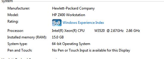

There are a lot factors that translate into model performace.  Obviously if you have a TON of modeled elements your computer is going to slow down as well as working with Point Clouds.  Your best bet is to make sure things are on worksets and only turn on the pointcloud workset when you need it.  Upping your performace in all categories will help but it is not cheap.  If you are looking into a new workstation you may want to take a look at http://www.boxxtech.com/boxx-workstations. However I have attached my computers specs and I don't have much problem working with large files when things are done correctly in Revit.
