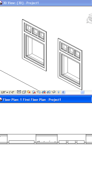

I just created a simple winodw family.
I don't understand it looks fine in the reference level within the family.
But once I placed it in the project, it only shows the top mullion, I had to delete the mullion to make the plan view look right.  What's the reason of it?
See attached.

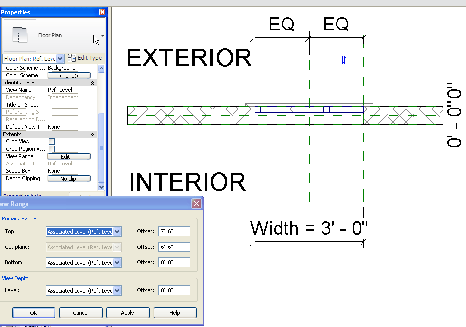

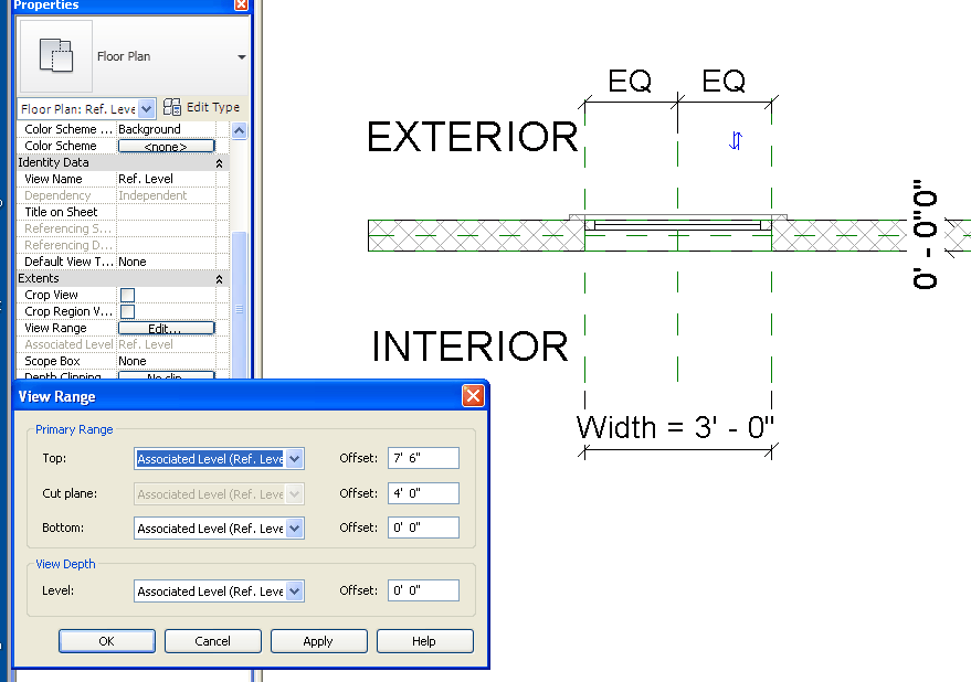

Alf, I did not have time to respond before.
Here is a crafsman window taken off the RevitCITY site.  On the left is the window as downloaded.  On the right is the same window but with the cut plane moved up in the family and saved.  As you can see, Revit does not work correctly in this instance.
109398_ScreenHunter01_Jul._30_10.02.gif109398_ScreenHunter02_Jul._30_10.03.gif109398_ScreenHunter03_Jul._30_10.03.gif

Mon, Jul 30, 2012 at 9:19:26 AM | Top mullion shows up in the plan view
3.5 Stars: 390 Votes
The first image IS THE PROJECT!  Same in 3D but not in plan!

Mon, Jul 30, 2012 at 3:06:22 PM | Top mullion shows up in the plan view
#10
Alf,
There are 3 images there.  The first on the left is a stacked project image with the 3D above the plan, and the views says PROJECT.  There is no plan regions and the two windows show differently in plan.  The other 2 images on the right are plan view of the families and the plan view properties showing that the cut plane is higher into the upper lite area.
3 images.....

4 Stars: 8 Votes
Ah, OK, there are 3 images. I had not noticed the first one. Thanks. So, according to those images, the height of the cutplane in the family DOES indeed affect the representation of the family in the project. Correct?
Planta1 Revit Online Consulting | info@planta1.com
Mon, Jul 30, 2012 at 4:01:06 PM | Top mullion shows up in the plan view
#12
right!
