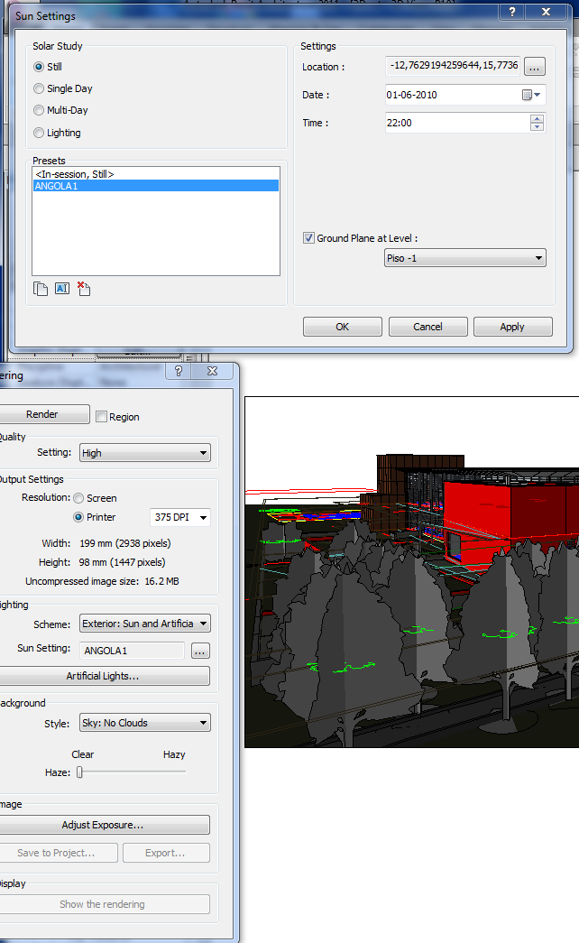

First Attachment is with settings on Exterior: Sun and Artificial and the Second attachment Setting are Exterior: Artificial only.

I create this one one and i think it's fine, play with adjust expose after the render.
Hope this help

This one....

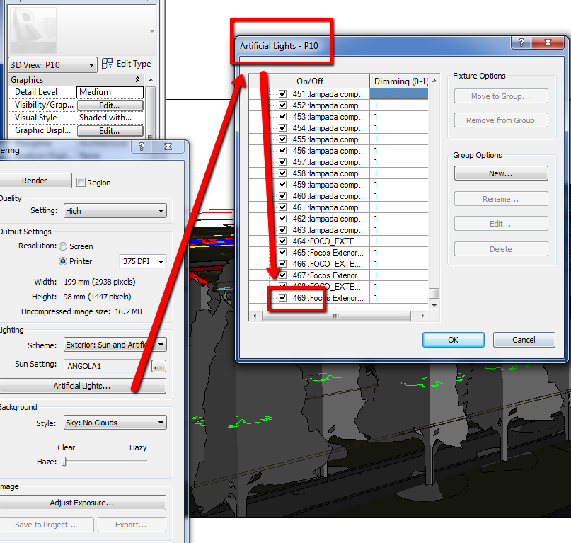

Well i have almost 470 lights in this model, 26 to 35 watts

What is your exposure set at and What about your exterior spot light settings?
