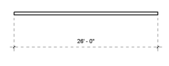

Fri, Aug 2, 2013 at 11:58:44 AM | Linetype of Dimension line
#9
3.5 Stars: 390 Votes
Oh ... and here is a 2014 dimension:
Fri, Aug 2, 2013 at 12:30:27 PM | WWHub
#10
Avex
Joined: Fri, Aug 2, 2013
6 Posts
5 Stars: 1 Votes
Quoting WWHub from 2011-03-28 13:48:13
"Same answer as Mr. Spot's previous answer."
Wow! What a great answer. Easy to have 12000 post just repeating what others say. Also, seems you don't like new people around. Great moderator :D
However, thanks for the answer. I hope that image don't be an override of the dimension element but a modification of the dim style instead. I will check 2014 asap.
Thank you all. Be happy.
