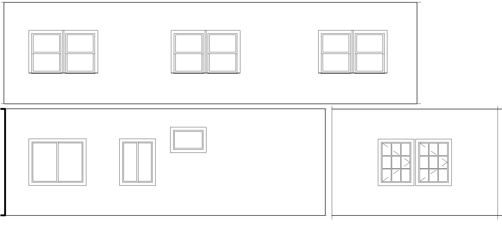

Hello!
Thank you for taking the time to read my post! This might not seem like it makes scene but its for a random project i'm working on.
I am trying to get an 2D image (maybe the wrong term) of every wall in my house (both sides to scale). Then i would like to some how export them in a way where all the walls shown. i attached this image to give an idea of what i'm talking about. I just used print screen and paint to show you what i'm trying to do. (not a realistic option)
Thanks so much!
-Grant

Wed, Sep 8, 2010 at 7:07:49 AM | Images of every wall....?
These  are called interior elevations.  In your plan, just add an elevation callout in your room and pick all four directions.  This will create 4 elevations which you can then place on a sheet or ... export, if that is really what you want to do.  (I think you may have a terminology problem here.)
Read your help >> Creating an Elevation View

WWHUB,
Thank you very much for your help. This is very close to what im looking for! i am going to play with it more when i get home with work.
