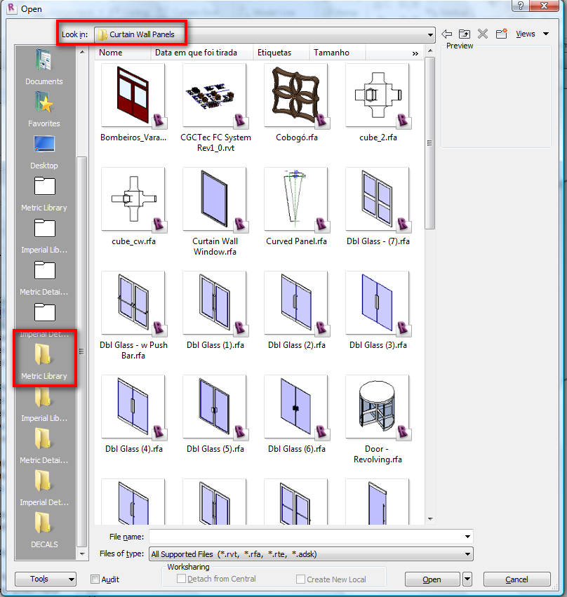

Everytime I try to insert one, it says it's the wrong Family type.
Sat, May 1, 2010 at 4:31:18 AM | looking for a steel flush door that works in Curtain Walls
Joined: Tue, May 22, 2007
5921 Posts
4 Stars: 205 Votes
You only can insert doors in a "curtain wall" IF those doors were created with "Curtain Wall Panels"...
Sat, May 1, 2010 at 7:14:07 AM | looking for a steel flush door that works in Curtain Walls
Modify a curtain wall door into a "flush curtain wall" door is your best method.
