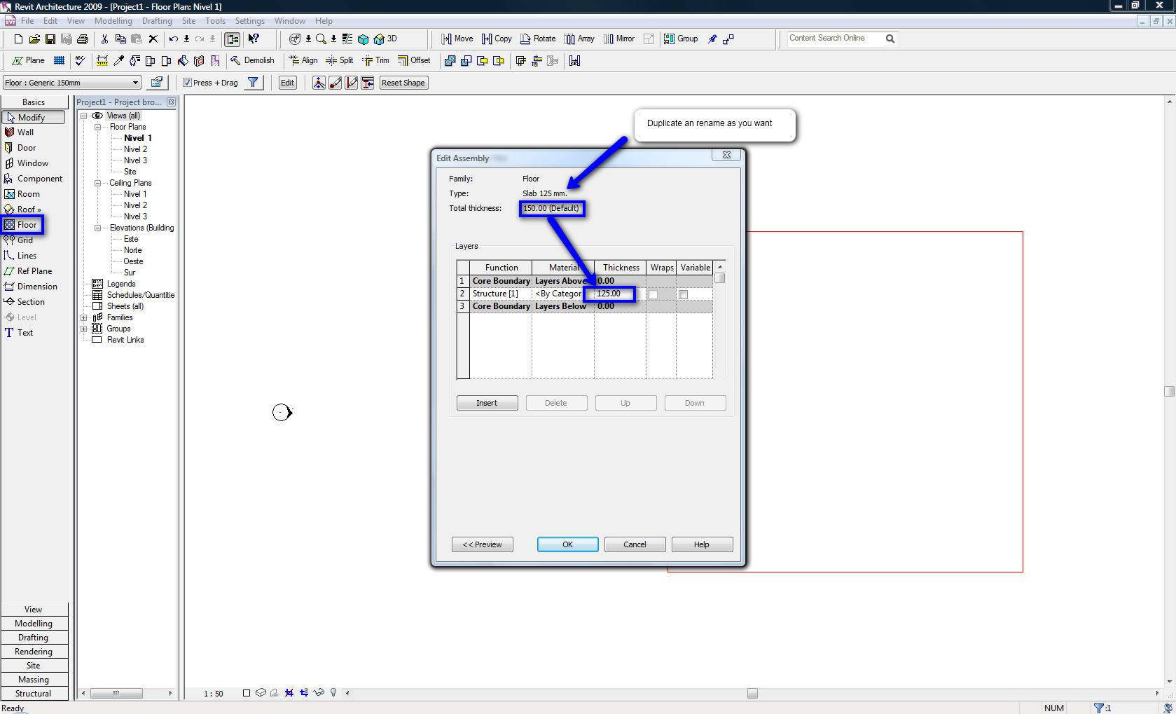

Hi guys, does anyone know how to create a conc. slab with 125mm thick?

First create a floor and duplicate it. Pick the floor (slab) and go to its propertiies and change its thickness....see image...

Oh! Ok!
Thanks!
