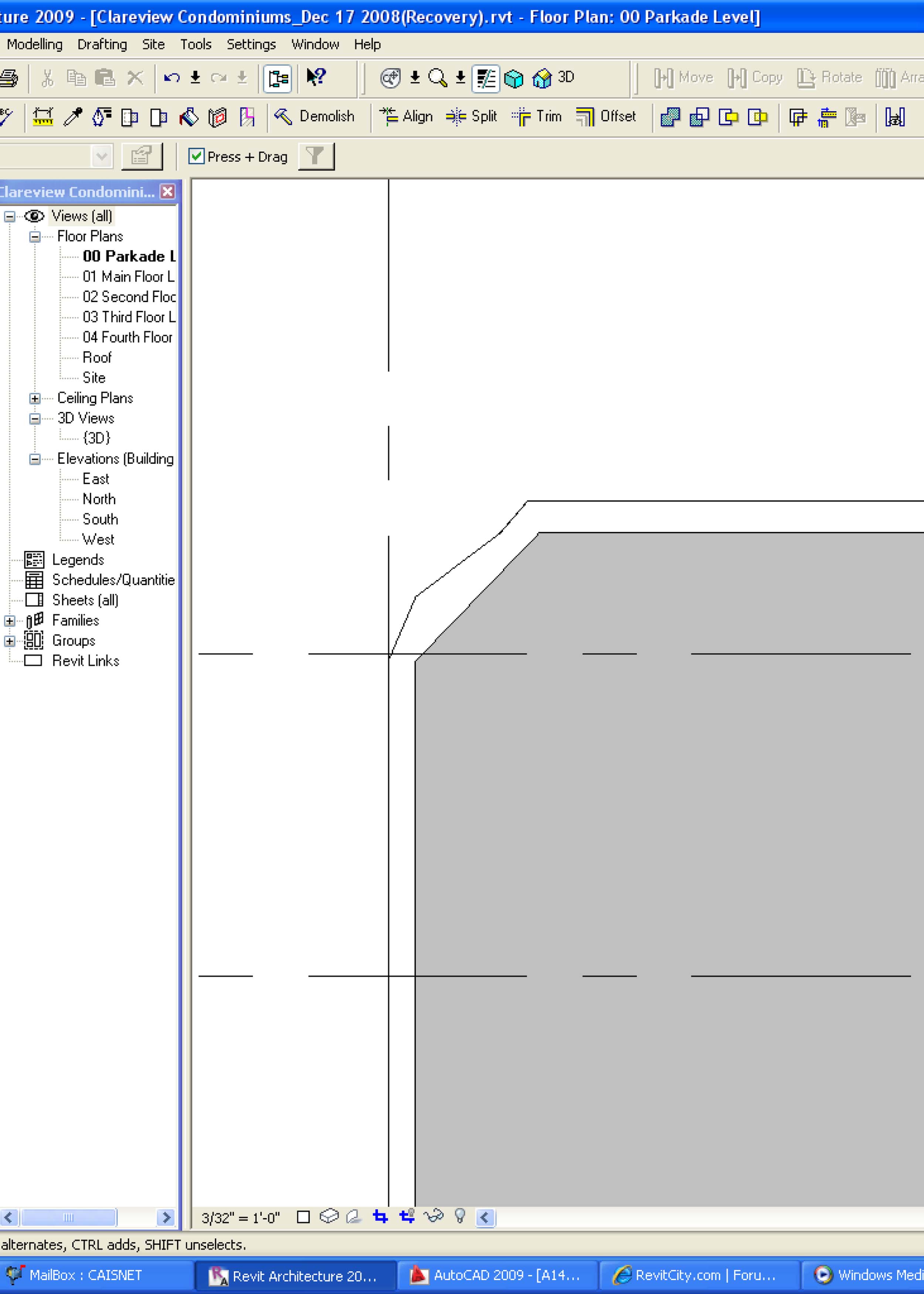

The problem is I can't find the true lines of the walls I draw. I mean when I draw the wall at 45 degrees, it shows some funny wall shape not 45 degrees. Earlier I thought it was a problem wiht the resolution of screen but now after correcting that It is everywhere in Revit.
If anyone has a solution for this please let me know urgently.
Thanks

I am trying to draw walls and when I draw any wall it makes the wall but shows two images of the same wall- one I can select which is fake and other one I can't select which is actual wall. It is making my life hell since I have to get something done quickly and it is not doing that. I checked other files of the project I did earlier, they are absolutely fine. Look at the Image I attached in my earlier mail.

Are the "OPEN-GL" Turned OFF???

It doen't matter if it is on or off. I tried both but ...

Like Coreed says, maybe it's a Graphic Card problem, drivers or so one...

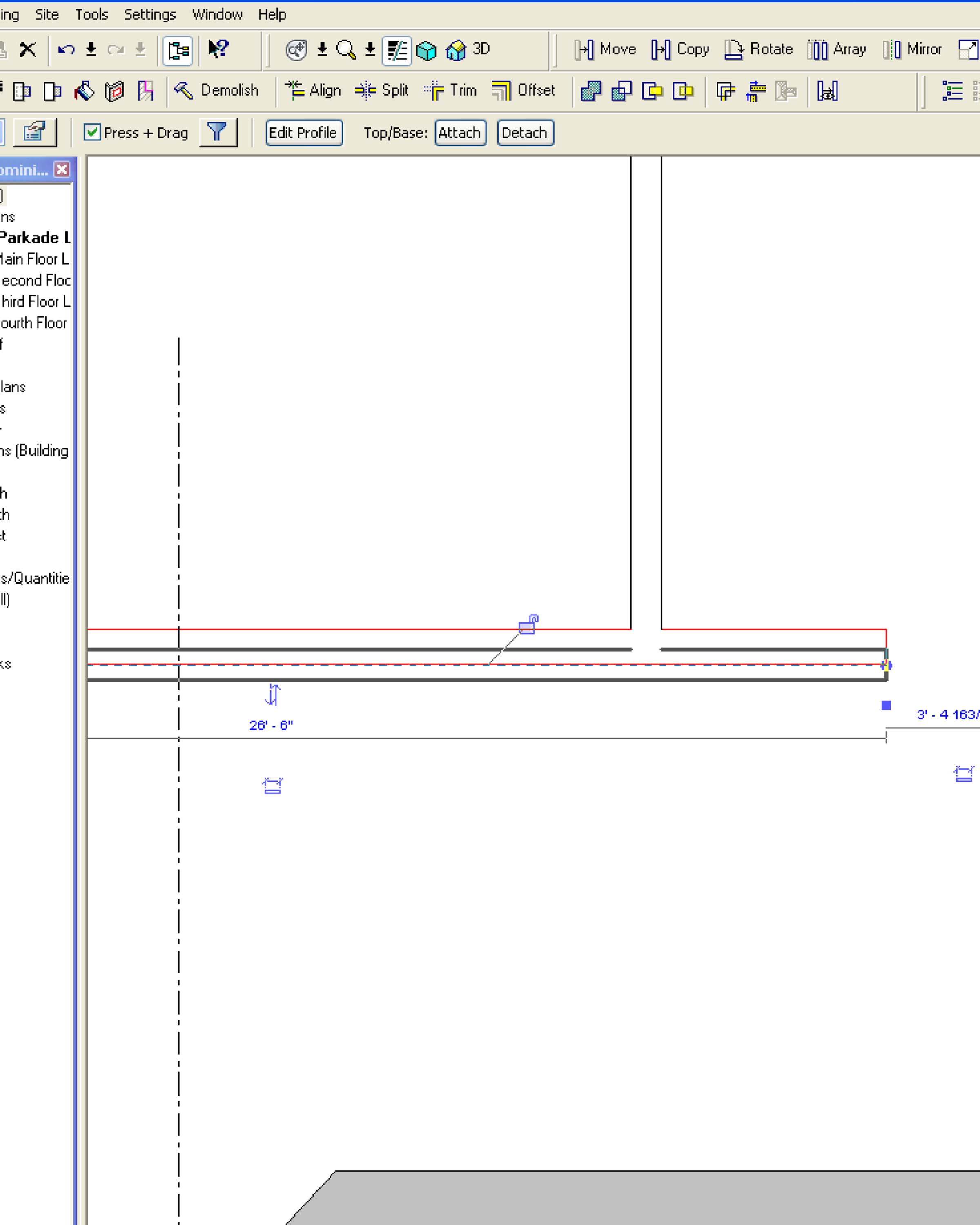

Okay I will give you another example- See attached-
Why I am getting two images only on this file and not in any other file I created or worked on.It is making drawing next to impossible.

Does this happen with only this wall type or all walls?  If you paste the wall into a different project does it still do this, or does it happen in all projects?

Like WWhub says, this doesn't make sense, can you put here to download that file so i can check????

Attach is the file for review.

There is something wrong with your file.  You may need to copy and paste into a new project.  I tried this and all the walls worked fine.

Yeah, it's very wierd, i never see something like this, when Copy-paste the walls to other new project it's Ok, there is something with this file....
